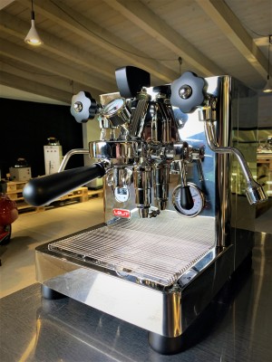

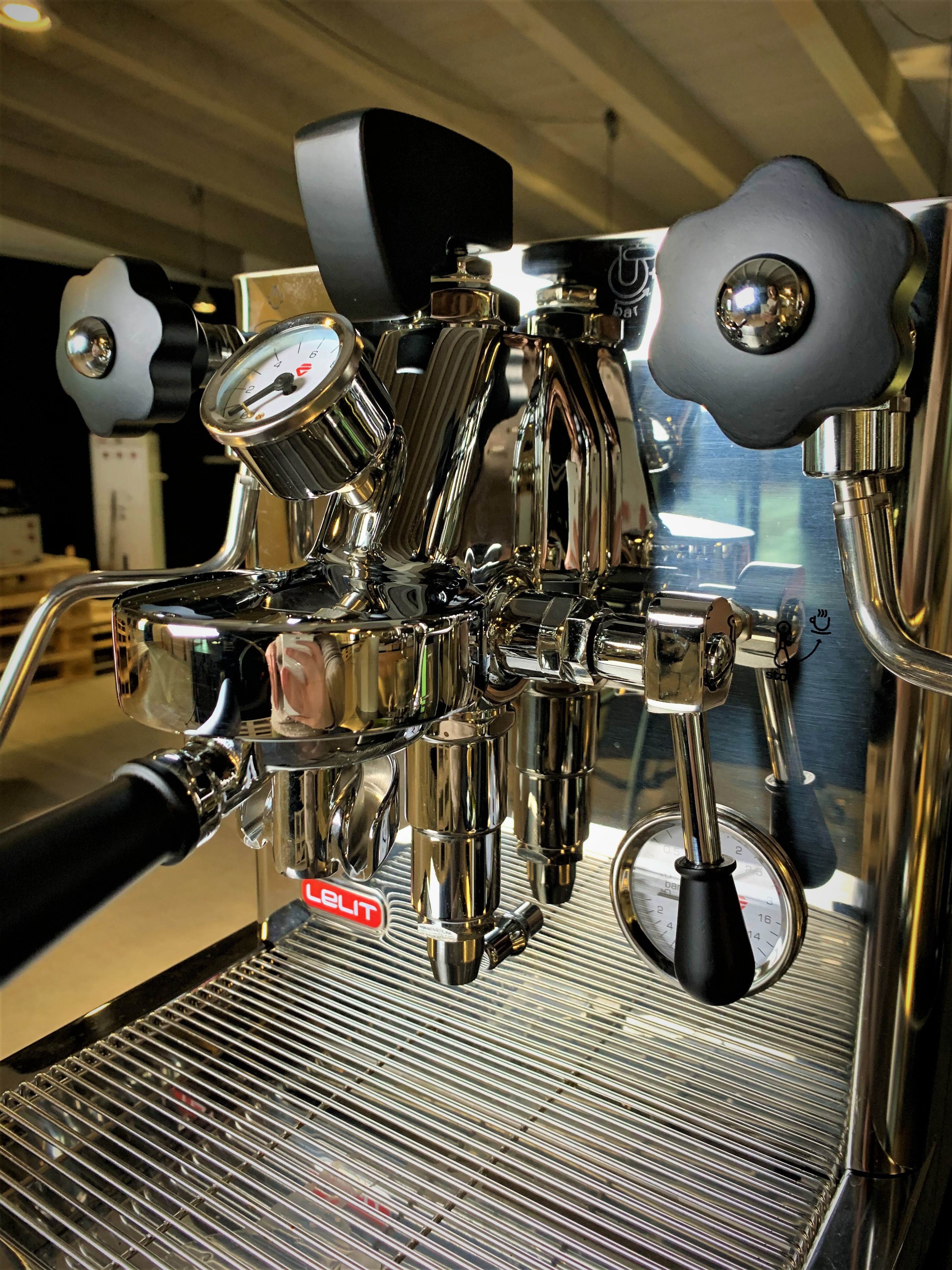

From the end of February we will have a kit with BLACK WOOD details for Bianca. This means that the client, buying the kit containing all the wood parts, will be able to have the Bianca in black and not “brown wood” version.
Bianca will always be produced with brown wood parts. The black details will be available JUST as KIT. Pls see below some pictures of our show room sample unit.
De set (PLA2201) omvat 4 voeten, 2 draaiknoppen, 1 groephendel en 2 filterdragers zonder filterbakje met een prijsopgave van €270,-
