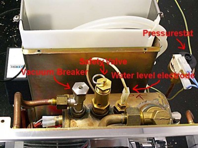

17Maybe you could flush less long and also turn down the pressostat for the boiler pressure/temperature a bit.

If the water seems too hot still, then maybe the boiler is set to be hotter than necessary.
What is the boiler pressure?

20If you want to set the boiler pressure a little less high this is where to find the pressostat:
https://www.coffeeco.com.au/articles/butterfly.html
